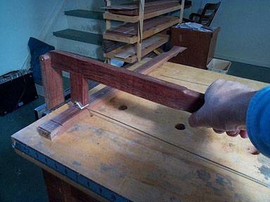

We had this one in a previous thread, can't remember whose it was but the whole design seemed very elegant and just made of scrap hardwood and a couple of bolts. The longer the lever the more pressure.

Yea read the article by Mario in Guitarmaker. It is an easy system to build and can work on one or two at a time. You can rig it to do with fretboard attached to neck or make a caul for the neck(he dosen't show that but easy to make)
